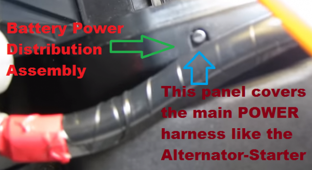

The "battery light" usually means that the Charging system has a problem, as to what though? Might need to investigate more into the battery and ground cable, and see where the positive cable goes into that "black box" just in front of the battery?
But that requires all that stuff you took off just to put the battery in, back off, and pull the battery out, so you can see where the distribution box assembly and it's conditions is in?
We are presuming you've checked the alternators pulley is fixed onto the ROTOR shaft and turns with the serpentine belt.
The panel is where the main Positive cable goes into.
But the Alternator and Starter - let alone other sub-systems
are getting their power from this panel.
The Blue arrow shows where one of the lift tabs are at.
Once the battery is out, this panel can be inspected more closely.​
So the choice it yours, but this system uses the positive cable to work into a Buss bar type of branching system that allows the bigger AWG gauge conductors to merge into this unit - so this takes the power from the battery and also places power back into it. So for you to see the charging Battery light, you might want to research in the owners manual on how to reset the battery monitor.
This Battery light is also a BMS system, but you live in the USA this may not directly apply to you. So the BMS system "checks" and remembers the voltage of the battery it sees in a window of time AFTER the ignition is off, and even while the engine is running - this timed checking process happens behind the scenes. You don't notice it. So for you to see the battery dash light on, and swapping alternators didn't seem to fix it - you will have to dig deeper or have a service department look at the cables to the Starter and Alternator and verify their integrity and nothing is corroded off or blown open - even back at the Battery Junction Box that adssembly is - by that battery.
