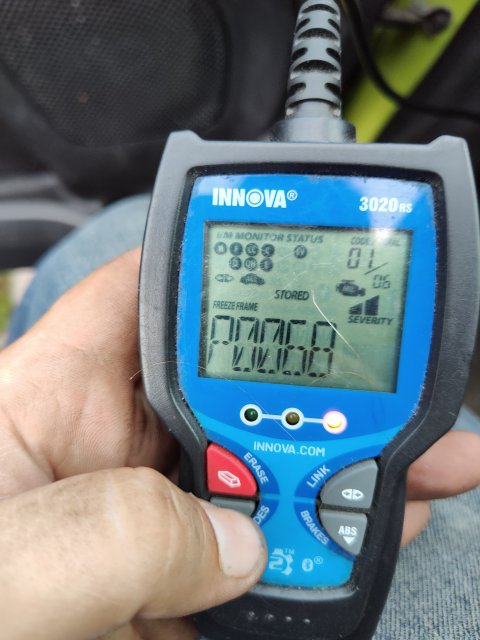

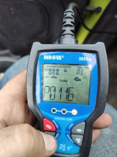

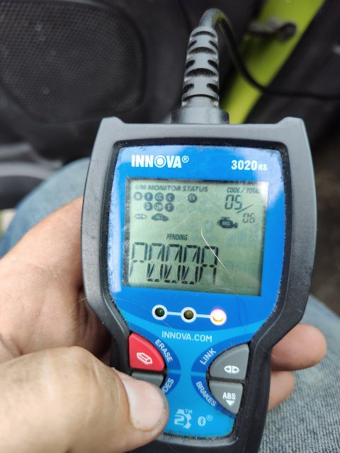

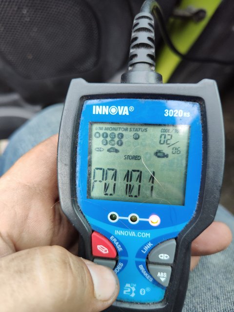

Hi I have a 2012 Ford Fiesta that has a crank no start issue, the timing looks good it is getting fuel to the fuel rail, it has spark!! I have included images of the codes that are currently present along with the no start issue, any help would be greatly appreciated!!
1,516
1,179
P0068 - MAF/MAP and Throttle position sensor correlation error
P0101 - MAF/MAP sensor Communication error
P0116 - ECT (Engine Coolant Temperature) sensor out of range condition
P000A - Camshaft Bank A slow response condition
So, either poor wiring harness, jumped timing belt or a pinched and cut harness with wires severed or poor ground point return from those sensors in the harness wiring.
Could also lead back to a blown fuse - no power to these sensors in the harness.
