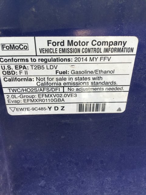

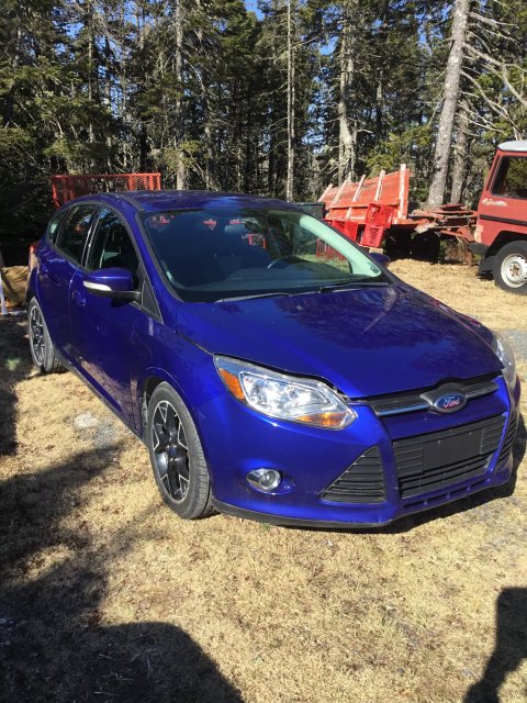

Hi Andy and thanks for your advice. Here is some new info.
Battery is brand new, fully charged overnight and connections and main ground to chassis freshly cleaned.
Replaced the electric gas peddle to no improvement. Replaced the throttle control device (throttle body) to no improvement. The throttle plate twitches when starting but does not "sweep" or cycle Through its range. Now, more often than not, after starting fine, there is zero effect to engine when pushing gas peddle. The engine just idles. Occasionally, after a fresh start, the gas peddle will allow the engine to rev but the action is very sluggish, as if the peddle is just slightly depressed, while in fact, it is pushed down a lot.

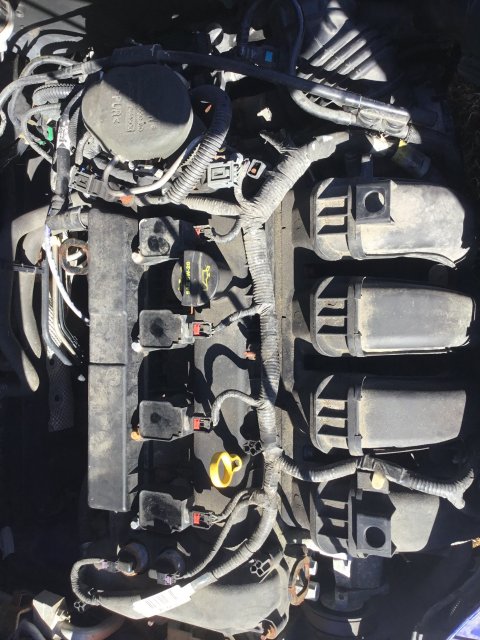

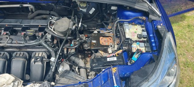

Here are photos of the car, engine top and emissions tag. I will toss in a can of Seafoam as it cant hurt. Still grasping at straws.

The Focus you have is Direct Inject so it's a GDI - so that means the injectors are not ruled out - just the fuel delivery system is still suspect.

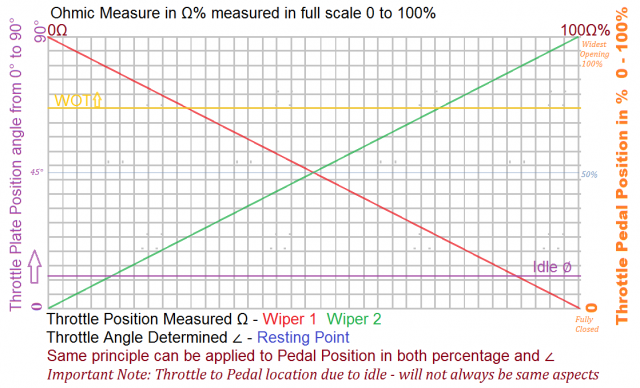

The Gas pedal on the Focus uses two "pots" one set up to read low to high while another reads high to low.
Referring to a way it sweeps the pedal and reports the resistance - these are Drive by wire, so the system is not seeing the changes - that information goes to the PCM - so the door pillar - the front kick panel - might have to be pulled and the main harness investigated.
So it's pretty simple you just keep the ignition on, but don't start the car - and remove the snorkel that has the MAF sensor on it - just detach the sensor connector to help remove the hose, but re-install the connector to power the MAF sensor during the test and let the hose dangle out of the way of the throttle plate view when you're ready to check the throttle body to wiring to pedal check.
Just have someone move the pedal and tell you how far down it is, and just observe operation using an inspection mirror or your phone camera to make a movie - just watch the plate move and have the helper call out the different "angles" they're pushing the pedal so you can watch the operation.
IF the pedal can be set to pretty much any angle - then the test passes - your issue is them more with the fuel pressure regulator and the high-and-low pressure switches used to "regulate" the regulator so it can deliver enough fuel to start and operate the car.
So if the system has not done an "idle learn" - that requires you to do the process - you pull the battery positive cable - and short it to ground to release charge in the fitler capacitors and force a memory reset - I did up a process of that is a Fiesta forum thread.

You also have to know that each throttle body resistance measured at "start" is slightly different - is a factor of the environment and the power applied to the system...
This might be a bit more than you need to know but it may help you understand what the relearn process does...
So the relearn is needed so the system can figure out the idle angle to set the idle speed and it's mixture in all conditions correctly.

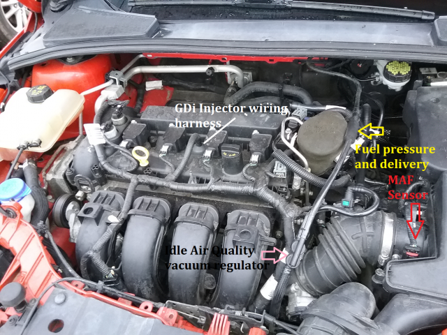

It's also why I showed you the engine compartment of what I'm referencing - for the Idle quality is also affected by another valve that acts like a splitter and keeps the brake booster supplied with vacuum so you can have power assisted brakes - on top of the fact that the vacuum line itself pulls in air and puts it in the intake - past the throttle plate - so when you are driving you have more air arriving into the system than just the throttle body's own plate positioning - it's thru that regulator arriving under or past the throttle - and affects the drivability of the car.
The other aspect that can affect the drivability is that fuel pressure regulator - it uses a pretty big spring and diaphragm in it to regulate and keep fuel pressure ABOVE the compression pressure in the combustion chamber - that's the GDI part - that injector is inside the cylinder not in front of the intake vales (TDCi) OR TBi or TCi). So there is more pressure the fuel system has to work against - but it also make this more efficient in some ways so the cylinder gets the fuel charge directly and not have to wait for the intake stroke and the injector or carburetors fuel charge - to get in there and hopefully ignite.

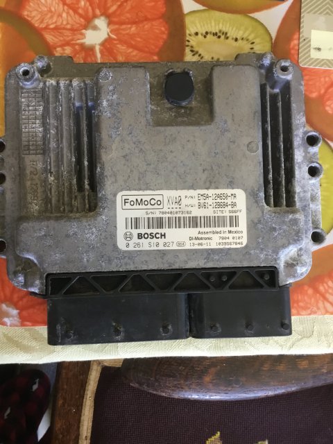

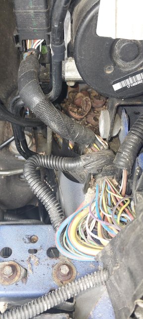

Found ECM in a black box behind and below the left headlight. You need to remove headlight assembly and the wheel well plastic liner to access it.

Locate that cover thingy - the one I posted to earlier as the Fuel Delivery system - the housing holds two sensors - a low and high pressure sensor.
To really know which is which, is to know by the size of the wrench it needs to use to remove the sensor.
Small sized wrench - low pressure - Larger wrench - (usually that sensor is to the outside towards the Driver side) - needs the larger wrench to remove that high pressure sensor..
So they use connectors - might want to run an ohmic check - see if the sensors are toggling when Fuel is needed or let it run down to low - then asks for more fuel.

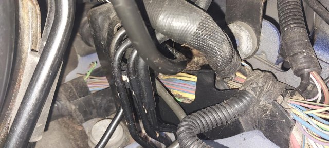

I pulled the main ECM/PCM from under the headlight but found its connections well secure and dry internally. Photo added.

Referring to the MAF sensor - the one on the filter housing.- when I went back to your photos...I saw this "dead grass" - thought it was below, on the ground - you didn't have a critter in there - did you?

Just need to see if the wiring got eaten - you should be able to probe those wires and get voltage readings off of them - when measured across to the Ground wire that is there.
